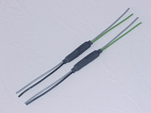

However, the rear O2's do absolutely nothing to regulate fuel, emissions, etc on your Z. There are just there to "tattle tail" to the ECU if your Z is putting our too much CO2 and cause the check engine light to go on, hence not needed. I have had mine completely disconnected for quite some time.
They pretty much are a resistor spliced between the plug and O2's.
